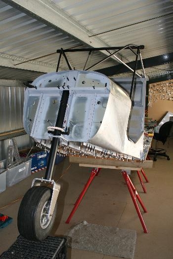

Brief Description:  nose wheel
The nose wheel hub was put together with inner tube and tire. A new valve stem hole is drilled out in a more accessable position and the old hole is filled with a provided plug. Then the wheel bearings are put in place as well as the axle. Next the whole assembly is mounted to the nose wheel bracket which in turn is bolted to the nose wheel strut. Now it's starting to look like something!
