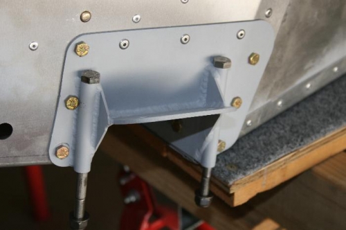

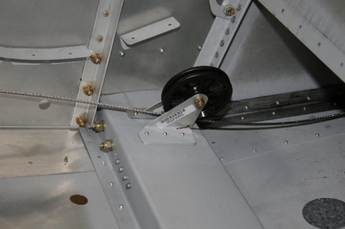

The fuselage landing gear/wing strut attach brackets were installed today. These pieces were tough to install. Most of the holes didn't line up so quite a bit of redrilling was required. I mounted the rudder pully assemblies also. The support brackets had to be set farther apart as they were rubbing against the pully wheel. Not a big deal but a bit fiddly to get free movemnet.
