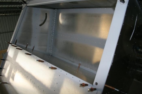

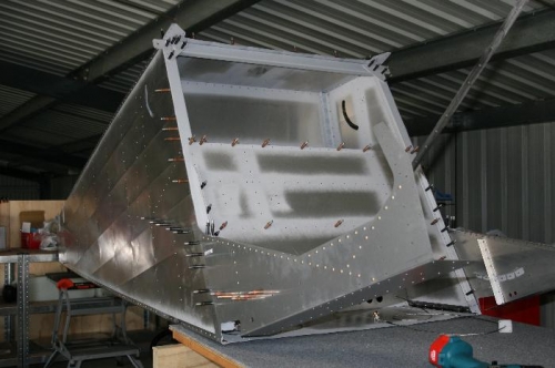

I started priming and constructing the forward fuselage today. I had a problem with the cross member behind the seatback panel. The angle of the "u" channel was too shallow preventing the installation of the seatback panel. Thankfully my hangar neighbor has a metal bending brake and kindly corrected the angle for me. That then allowed me to finish the baggage compartment. I also roughly put together some of the cabin floor structure.
forward fuselage sides added
fuselage under seat structure
baggage compartment
baggage compartment
