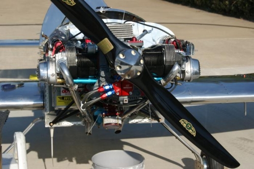

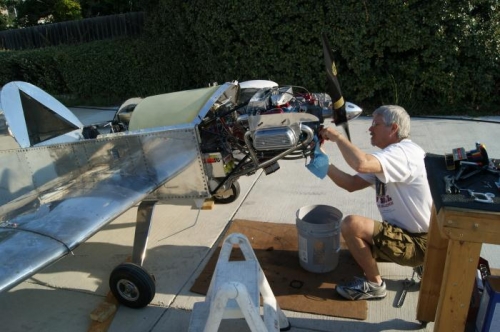

Applied red RTV to the rear plug on the oil cooler standoff and the 4 right side push rod tubes.
Ran the engine for about 10 min. All pressures and Temps were in the green. It appears we solved all oil leaks on the front of the engine but it was leaking profusely around the fly wheel. We will have to pull the engine this coming week to get at that to diagnose and repair. 1 step forward and 2 steps back!
