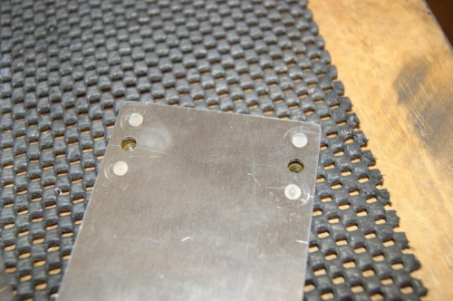

Brief Description:  Wheel pant attach plates, wheel spacers

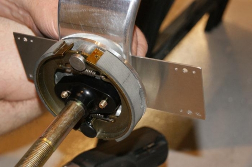

Derek 5 hrs (on vacation!!) Worked from 1 to 6. Started to put together inboard ribs and wheels. Back riveted solid rivets on the wheel pant attach plant. Looks great! Used a cartridge roll to open up the wheel spacers to they would fit on axle. bolted and fit wheel and main nut. brakes are a little snug but should loosen up quickly once the plane starts rolling
backriveted solids to attach nutplates to wheelpant plate
had to use cartidge roll to open up spacer to get on shaft.  bolted into place inside drum
