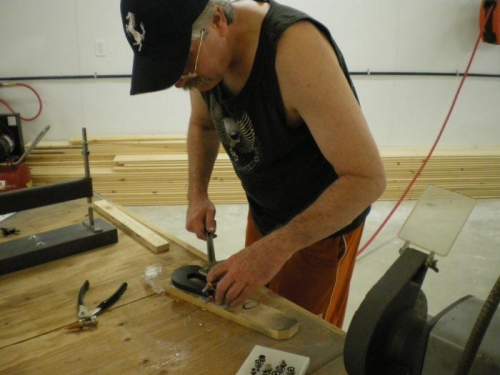

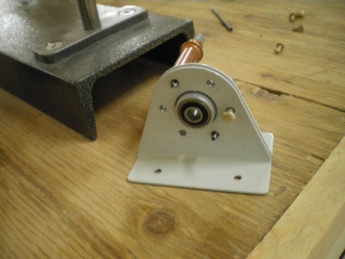

Brief Description:  Drilled, deburred, & began dimpling
Upon dimpling the HS 603PP, used the 1/8" dimpler by mistake and made holes on the bottom side of this piece too large. Will call Van's to see if I can use a -4 countersunk rivet for the 37 holes or need a new part. Will call them on the 2/22 as they are closed for President's Day.
Still have the right HS to remove, deburr, and dimple.
