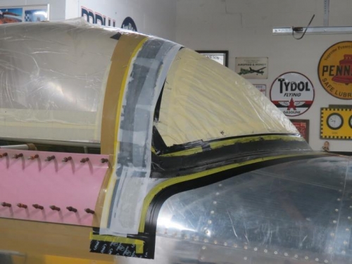

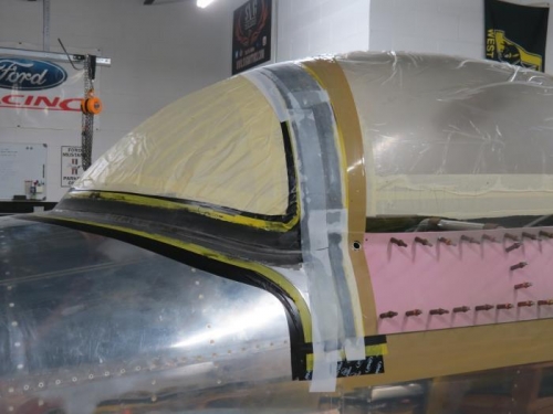

Brief Description:  Glassing the canopy and windscreen
These photos show the glassing that covers the windscreen where it is screwed to the canopy bow and creation of the "lip" that overlaps the sliding canopy. This task had me scared a bit since I had heard stories about how hard separating the canopy and windscreen can be after this step. That is why I haven't yet riveted the skirt to the caniopy frame. I thought it might be necessary to remove the skirt so I could grasp the frame and pull the slider free from the windscreen. As it turned out, the canopy came loose fairly easily. I can now breathe easier!
Starboard Side View
Starboard Side View
Port Side View
Port Side View
