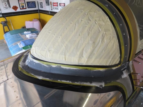

Date:  6-16-2017
Brief Description:  Windscreen to fuselage fillet
I began the glassing task by laying cloth around the windscreen where it attaches to the fuselage skin. Multiple layers of cloth will be required followed by some filler to make it look nice and finished. I always use peel-ply to soak up the excess resin and make for a smoother finish for the filler and sanding.
