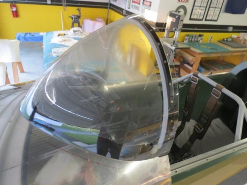

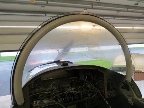

Number of Hours:  6.00
Brief Description:  Creating windscreen fillet
You will recall I used washers as spacers between the canopy bow and the windscreen. Today I finished fabricating a fillet of varying thickness to fill the area/gap between the bow and windscreen. I managed this by filling the area between the spacers with the same paper clay material used earlier sculpting the canopy skirt. After sanding it to rough shape I used Poly-Fil and more sanding to get the final shape. Then it was a matter of taping if off and painting it black.
I should mention, the clay material is more like poly-fill than clay. It is paper and water based and when cured it becomes hard and may be sanded and painted if desired.
The Finished Fillet
The Finished Fillet
With Windscreen Attached
Aft View
Aft View
