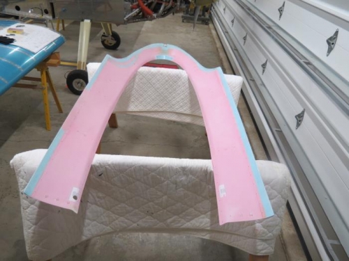

Brief Description:  Finishing work on underside of skirt
I buttered the edges of the skirt while it was on the airframe and slid it closed to get a flush fit to the fuselage skin. The filler was then sanded smooth and relieved just a little for a nice fit. There is a layer of glass cloth and resin over the blue filled areas for strength. If you look close you can also see the nylon spacers mentioned earlier.
Also took a few minutes to clean up and repaint my Garmin GPS antenna. I used a light coat of flat black paint which should not interfere with RF reception.
Underside of Skirt
Underside of Skirt
