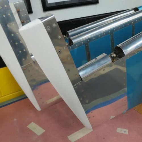

Brief Description:  Finishing of fiberglass tips

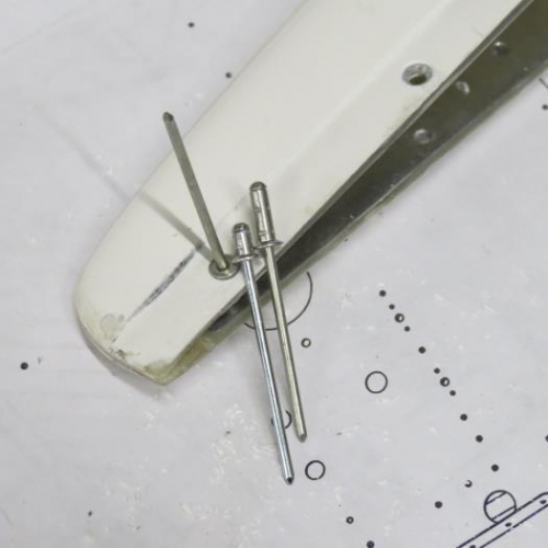

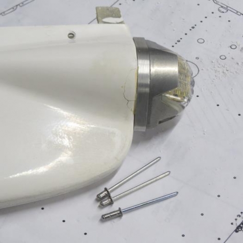

Continued fitting various fiberglass parts to the empennage. One of the areas presenting a challenge are the extreme aft end of layups. The trailing edges are so narrow that opposing rivets tend to interfere with each other. After some thought I decided that it might be possible to shorten some of the blind rivets called out in the plans.
Turns out it is fairly easy. I began by removing the mandrel. Then using a Dremel I cut the rivet to a shorter length and reinstalled the mandrel. The result was rivets short enough to avoid hitting the opposing side rivet. This allows the rivet to be set cleanly and easily.
Modified Blind RIvets
More Shortened Rivets
Rudder Top Cap
Rudder Top Cap
