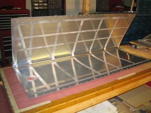

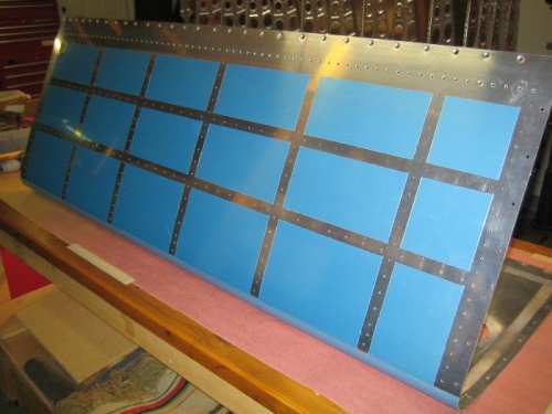

Today was one of those mind-numbing sessions in the shop. I began removing the plastic protective coating from the rivet lines and then deburred all the holes in the tank skin (inside & out). The next task was to tape off the matching surfaces inside the tank and scuff with scotchbrite pads. I am waiting for a set of tank dimpling dies so the tank skin and ribs were set aside in favor of preparing the aileron brackets.

Mating Surfaces Scuffed
Plastic Removed
Plastic Removed
