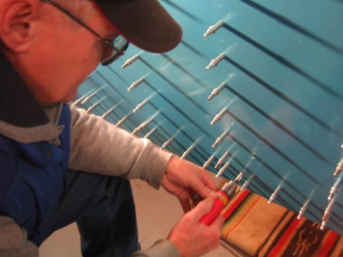

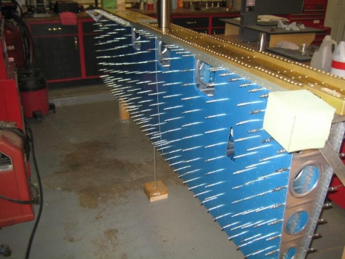

Today I finished clecoing both the bottom and top skins on the starboard wing skeleton. After clecoing, all holes for the ribs, main, and rear spar were match drilled. Three reference lines were also struck to locate the point for later drilling of the leading edge skin for the tie-down ring.
Match Drilling Wing Skins
Bottom Skins Done
Bottom Skins Done
Top Skins Done
Top Skins Done
