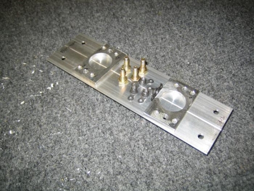

After the platenuts, it was on to fabricating the tie-down bracket. All the parts have been cut, match drilled and deburred. Once primed, the assembly will be riveted together and installed on the spar. It will then be tapped for the tie-down ring.

Tie Down Bracket
Tie Down Bracket
