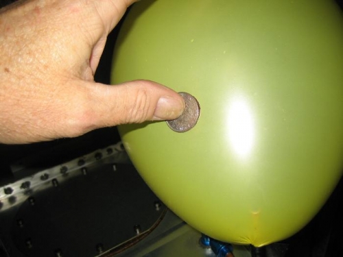

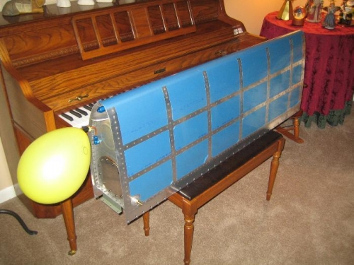

Left tank pressure check (168 hrs)
After 168 hours the left fuel tank shows very little pressure loss. The original outline of the quarter is still slightly visible around the circumference of the coin.
Check at 168 hrs
Checking Outline
