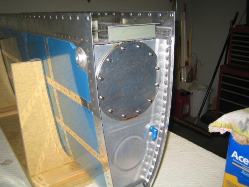

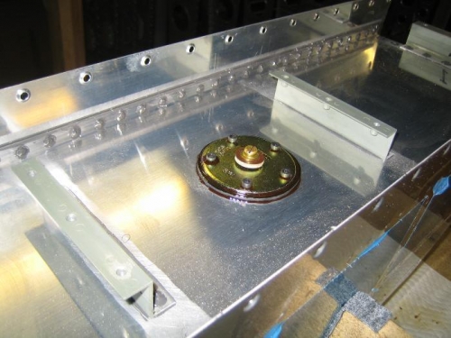

I installed the tank access plate and fuel sender using the supplied gaskets and an aviation gasket sealant from Permatex (available at the local NAPA store). I replaced the supplied pan head screws with CAP screws having a socket head (Allen wrench compatible). Both sides of the gaskets and contacting surfaces were coated with the sealant and the fasteners tightened evenly.
I know there are numerous opinions on how best to seal the sender and access plate. I decided to try the original method. If the gaskets leak, I can always go back and use the proseal method. I will give the tank another day or so to cure and then comes the leak test.
