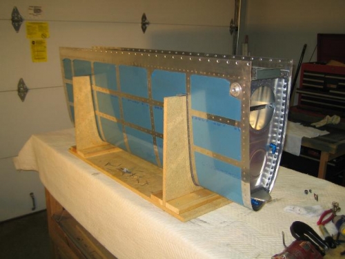

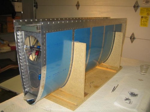

Left Bottom Finished
Left Top Finished
Left Top Finished
