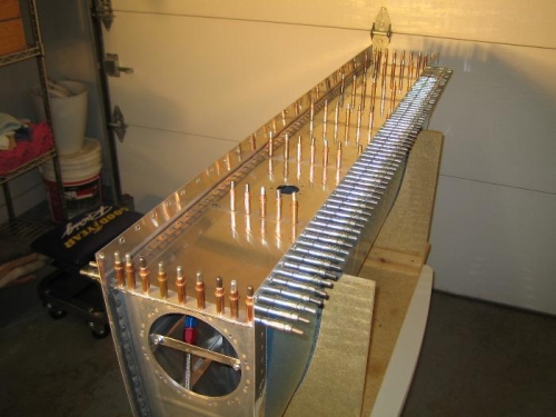

Date:  11-22-2009
Number of Hours:  4.00
Brief Description:  Installed rear tank baffle with sealant
Well, after one more inspection of the tank interior I iinstalled the rear baffle. Again, I have sealed the appropriate surfaces and clecoed 100%. After 24 hours or so of set-up time, I will set the rivets wet and install the mounting flanges. After that, the only task left will be to seal the access plate and fuel sender, let the tank cure, and then leak test.
Baffle Sealed
Baffle Sealed
