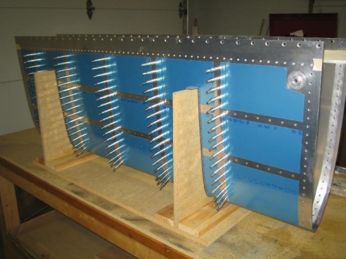

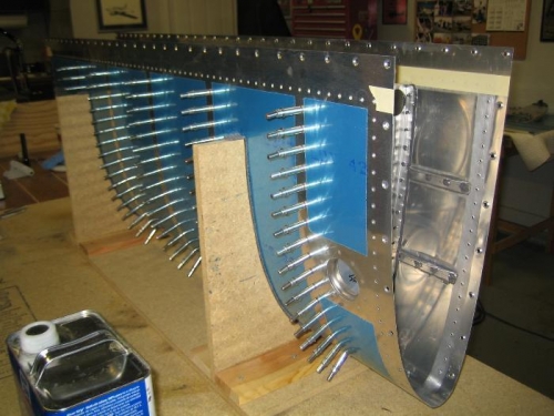

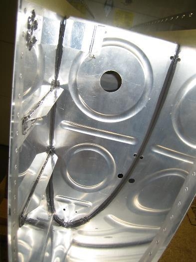

Tonight I decided to seal and set the five internal tank ribs in the skins. I am following an alternate procedure for sealing the tanks that has been discussed at great length on the Van's Air Force website. That is, set the prosealed ribs into the skin and cleco 100%. I will let the sealant setup a day or two and then drive the rivets wet. While there will no doubt be a little mess when driving the rivets, getting the sealed ribs into the skin was relatively clean.
I am still not excited about working with proseal and will be glad when the tanks are complete. I sure hope they are leak free!
