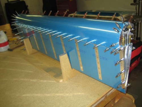

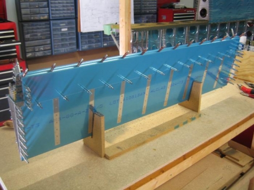

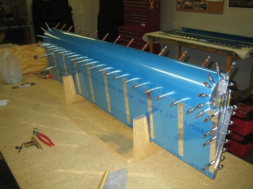

I began the morning by reinstalling my homebuilt metal brake on the workbench and making the final bends in the two aileron skins. Before making the bends, I taped a 1/8" wooden dowel in the trailing edge to ensure a proper radius.
Once the skins were bent, the left aileron was fully assembled and all holes were match drilled to correct sizes. The same procedure was followed for the right aileron. Both ailerons were then disassembled for deburring, edge dressing, dimpling, and priming. I plan to prime the reinforcement plates, end ribs, nose ribs and the counterweight (inside and out).

Bottom Left Aileron
Bottom Left Aileron
Top Left Aileron
Top Left Aileron
