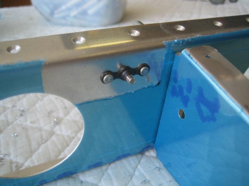

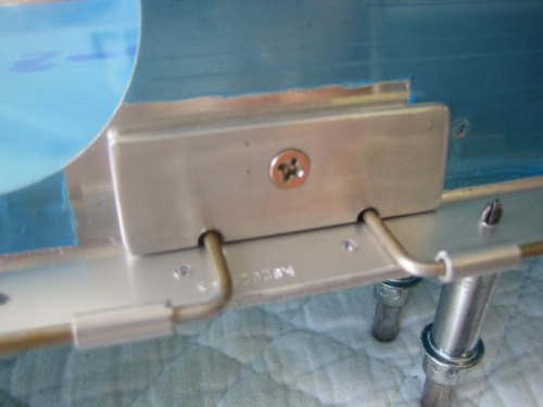

I decided to use the two pin alternative for securing the flap hinge. This required removing three eyes from the hinge (one on the flap side and two on the wing). Rather than removing the eyes in the exact middle, I made the cuts slightly outboard to get away from the lightening holes. I fabricated a small pin retainer from some scrap aluminum and secured it to the spar with a nutplate and screw. The pins should be fairly easy to remove and insert with the flap hanging straight down.
