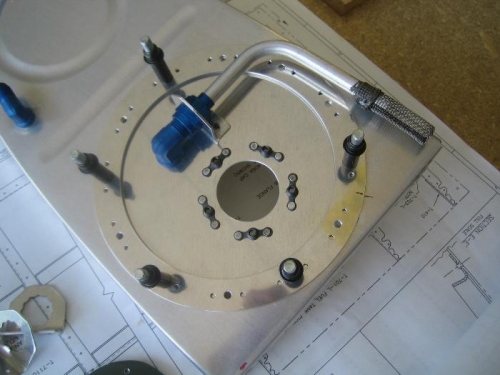

I did a quick test fit of Van's fuel pick up tube and it was perfect. The design of the anti-rotation bracket eliminates the need to safety wire this connection. The connector on the flop tube will, of course, require safety wire to guarantee it won't come loose once installed.

Test Fit Van's Fuel Pick Up
