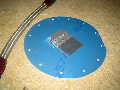

I ordered an extra piece of piano hinge for fabrication of the inverted fuel trap door and future use in making an access panel in the rear bulkhead of the front baggage compartment for easier maintenance of avionics.
My first task for the day was to make the inverted fuel trap door per the plans. While test fitting, it is apparent the door really won't completely seal the hole in the rib. The hole is cut so close to the flange that the door can't cover the opening completely. I suspect in actual operation there will be some fuel leakage past the door perhaps at more than one point. However, the door should slow down the migration of fuel from the inboard bay to allow a brief period of inverted flight without engine stoppage (I hope).
