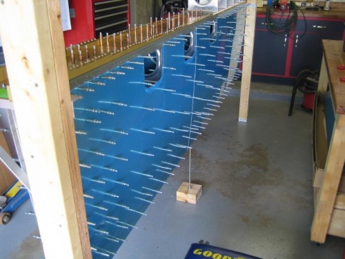

Match drilling main skins
Clecoed the top and bottom main skins to the spars and ribs. Match drilled all the holes attaching the skins to the spars and ribs. After all holes were drilled to final size, the bottom skins were removed and set aside.
