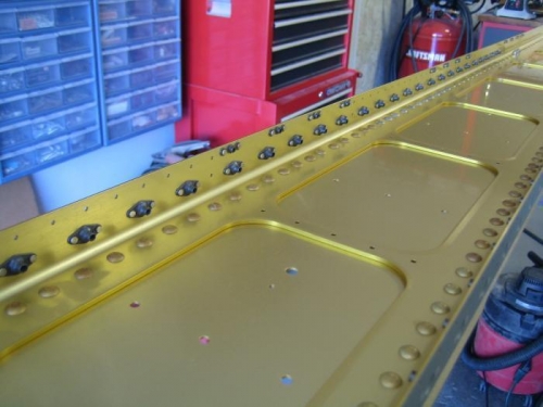

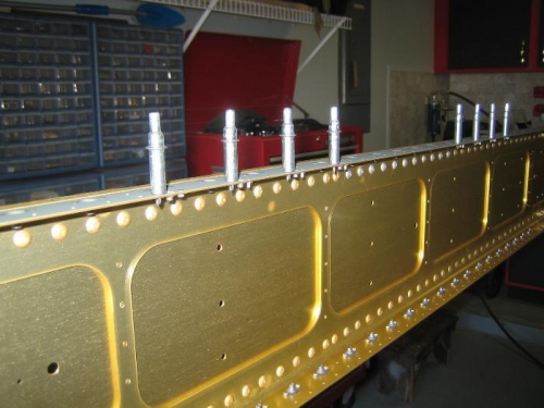

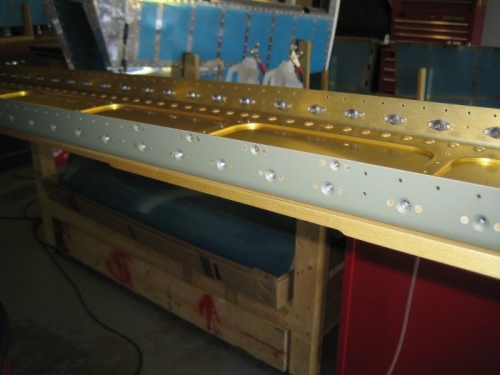

Brief Description:  Riveted nutplates on left wing
There are a lot of nutplates on the main wing spars but they install fairly fast if you have a pneumatic squeezer. I did the squeezing with the spar mounted vertically in the jig but thinking about it later, it may have been a little faster if it was mounted aft side up (could have probably skipped the cleco and let the rivets hold the plate until squeezed). Anyway, all the nutpplates on the left wing are done and the results are good.
