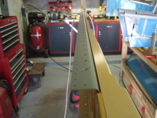

I began the day by priming the spar flanges to protect the countersunk areas from corrosion. I have seen this step done a number of different ways but for speed I decided to prime the entire flange out to the last nutplate. Later when the skins are match drilled and the spar requires more countersinking for the skin dimples, I will reprime the entire flange.

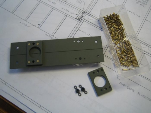

My next task for the day was to fabricate the tie down assembly and get it mounted. This part took a little longer than expected due to the lightening hole in the spacers. For simplicity I thought about cutting a solid spacer but then decided to follow the plans. I used a 1" hole saw to cut the hole but it took some effort. I modified a cheap hole saw by grinding the "set" out of the teeth (every other cutting tooth is set at a slight outward angle). I then drilled a pilot hole in the aluminum stock and followed up with the hole saw. All this was accomplished on a drill press using Boelube for lubricating the saw. Well, it worked and the spacers look good but it was a slow process. I will probably look for an alternative procedure when it's time to cut lightening holes again.
Primed Spar Flanges
Primed Spar Flanges
Tie Down Assembly
Tie Down Assembly
Tie Down Fabricated
Tie Down Fabricated
