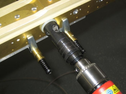

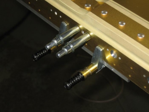

I had hoped it would be possible to make a drilling jig to do six holes at a time but the platenuts are not spaced evenly down the spar flange. You just have to accomplish this task one hole at a time. The sequence is cleco the jig, clamp the jig plate on each side, remove the clecos, countersink the spar, and finally remove the jig and continue with next hole.

Jig Clamped in Place
