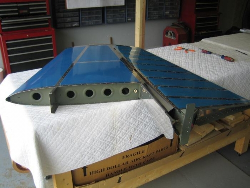

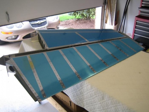

I inserted the rod end bearings in the rudder per the measurements on Van's plans. Fit seemed good but will probably require a little adjustment later. When swinging the rudder it seemed to be a little closer from the midpoint to the bottom than at the top. I think this can be corrected by either adjusting the top in slightly or the mid and bottom bearings out slightly. I will worry about this a little later.
