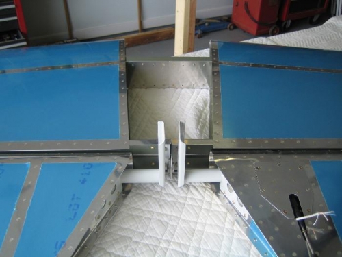

Brief Description:  Test fitted both elevators to the horiz stab
Assembled the elevators and horizontal stabilizer to check overall fit and alignment. With the hinges (rod bearings) set at the specified 13/16" (spar web to centerline of bolt) and the elevators in trail the tail assembly looks good and straight.
Horns in Alignment
Horns in Alignment
Looks Like a Tail
