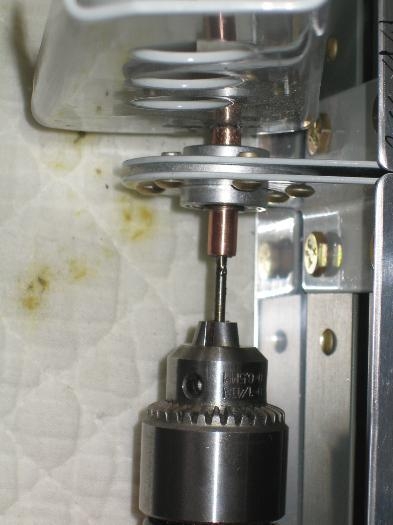

Brief Description:  Mounted right elevator and drilled horn
Mounted the right elevator, inserted the hinge bolts, and clamped the elevator in trail with stabilizer. Using the drill bushing previously fabricated, drilled the elevator horn to #40. Once the elevator was removed, the hole in the horn was final drilled to 1/4" to accept appropriate bolt.
Drilling the Horn
Drilling the Horn
