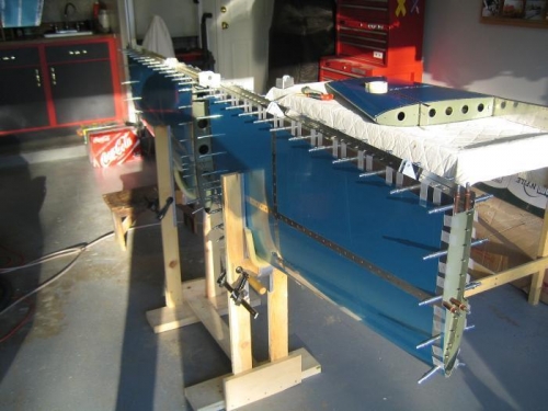

Brief Description:  Prepared horizontal stab for final riveting
Adjusted the work stand to position the horizontal stabilizer at comfortable height for riveting the rear spar, end and root ribs. I am using the same procedure for the horizontal stabilizer as used for the vertical stabilizer. That is, deburring the holes a second time, taping rivets and squeezing with the pneumatic tool. By the way, I use a couple differnt C yokes in the squeezer to get all the rivets. Some rivets are in tight spaces (leading edges) and are easier to access with an alternate yoke.
Horiz Stab Prepared for Rivets
