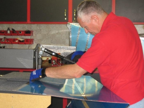

Deburred all rivet holes and the edges of the vertical stabilizer skin (scotchbrite wheel with die grinder). Checked preloading on the DRDT-2 and dimpled the stab skin.

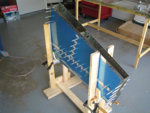

Clecoed the vertical stabilizer skin to the skeleton in preparation for final riveting.

Dimpling the Vert Stab Skin
Ready to Rivet
Ready to Rivet
