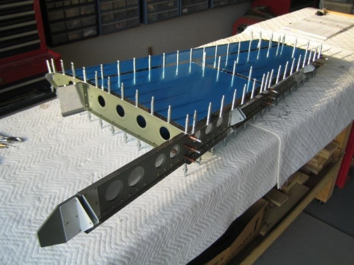

Brief Description:  Match drilled new vertical stab skin to skeleton
Assembled the vertical stabilizer skin and skeleton (all spars and ribs). The pilot holes in the skin matched perfectly with the understructure. Clecoes were inserted in every other hole to ensure exact skin positioning. All the holes were match drilled. The holes on the lower edge of the stabilizer where the empennage fairing will attach were marked (they will not be riveted).
Match Drill Skin to Skeleton
