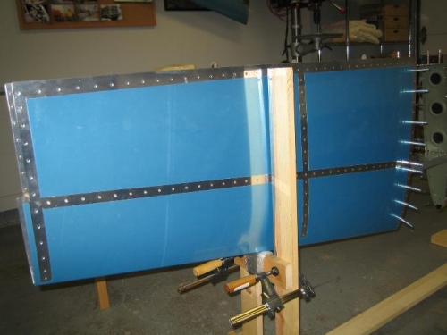

Brief Description:  Riveted bottom side left horizontal stabilizer
Riveted the bottom side of the left horizontal stabilizer. Connie handled the gun and I held the bucking bar. I recommend riveting with a partner when possible. Quality of the work is consistently better. I also recommend a work stand as pictured to get the assembly positioned so the bucker can reach and see inside the structure.
