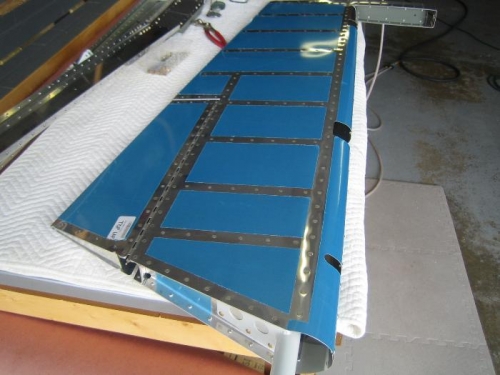

Installed trim tab on elevator
Installed the trim tab on the elevator and checked full up and down movement. The lower skin was bent slightly upward forward of the trim tab spar to keep tab from rubbing the elevator when pivoting trim tab to full down position (nose up).
Left Elevator with Tab
