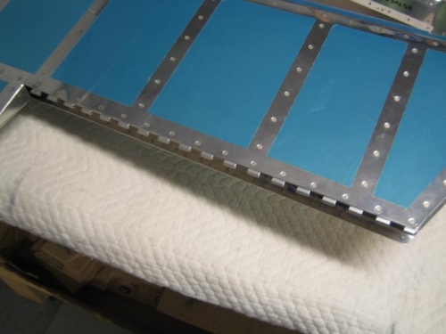

Brief Description:  Attached trim tab hinge to elevator
Positioned and riveted the trim tab hinge to the left elevator assembly. The hinge rod was inserted to help prevent the hinge from distorting. Hinge installation was true and straight with no deformation or binding.
