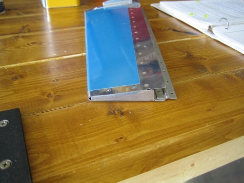

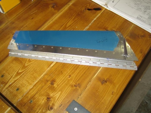

Brief Description:  Completed final assembly of trim tab
Assembled the trim tab with cleco fasteners for final fit check. Riveted the bottom skin surface to the spar using the pneumatic riveter with new longeron yoke (reaches over and around the spar nicely. Positioned end ribs and riveted. Positioned and riveted the trim tab horn to tab assembly. Finally, positioned and riveted the hinge to the upper trim tab skin and spar.
Trim Tab Completed
Trim Tab Completed
