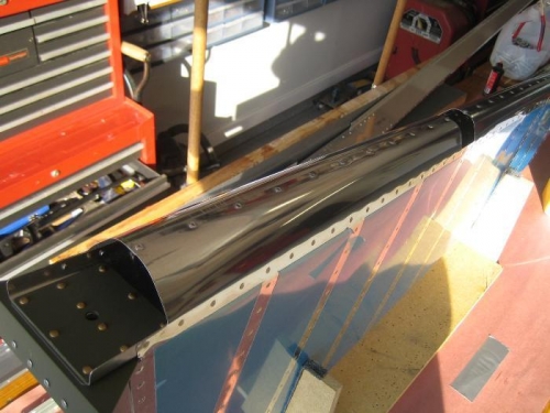

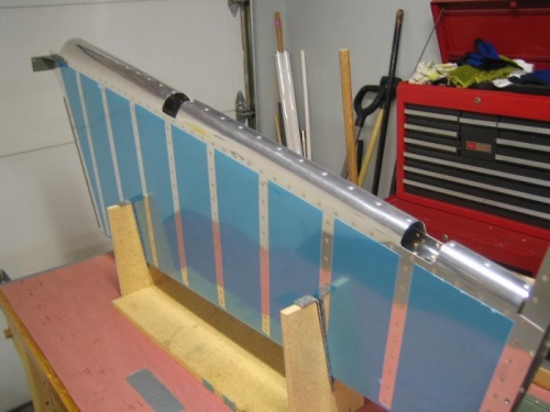

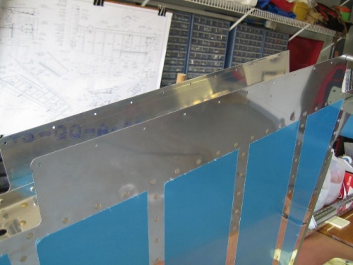

Brief Description:  Completed rolled leading edge
Fabricated the rolling tool for the final segment of the rudder leading edge. Match drilled the rolling tool to the rudder tabs to be rolled and riveted using temporary pop rivets. Used the Cleaveland edge finishing tool on the skin to be overlapped. Rolled both rudder tabs, pulled into place and fastened with clecoes, and finally riveted using blind fasteners. Good results.
Rudder Bottom Segment
Bottom Segment Riveted
Leading Edge Completed
