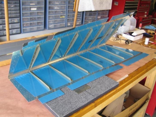

Match drilled stiffeners to right elevator
Remove protective plastic from right elevator skin. Match drilled stiffeners to top half of elevator.
Prepare elevator ribs for primer (cleaned up edges and fluted as appropriate).
Stiffeners Installed
