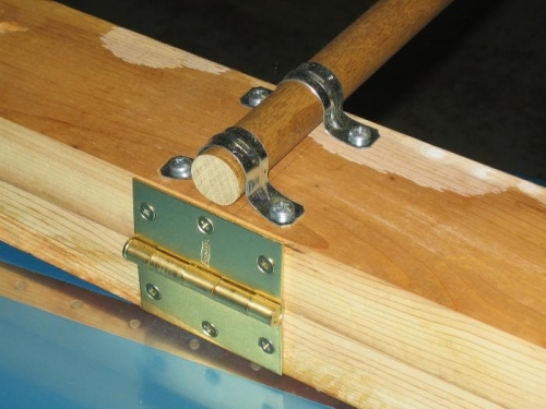

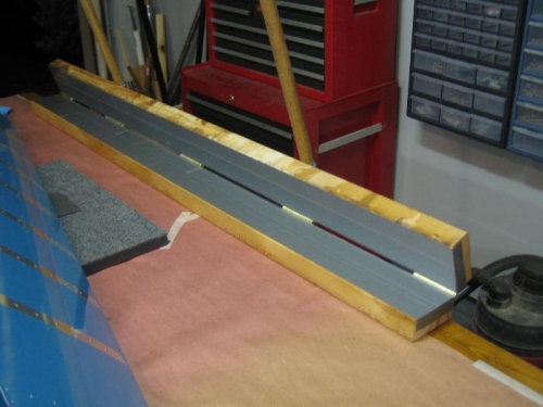

Fabricated a metal bending brake to crease trailing edges of control surfaces (elevators, rudder and trim tabs). I built the break from a 2x8 ripped up the middle and connected with some sturdy door hinges from Lowes. The handles were made from an old broom fastened to the brake with electrical conduit clamps.
Brake for Trailing Edges
Hinge and Handle Detail
