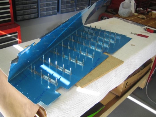

Prepared rudder stiffeners for final assembly
Clecoed the rudder stiffeners to skin in appropriate positions.
Match drilled the rudder skin to stiffeners (#40).
Marked the stiffener positions and disassembled.
Deburred holes, smoothed edges, dimpled and primed the stiffeners.
Match Drill Stiffeners
