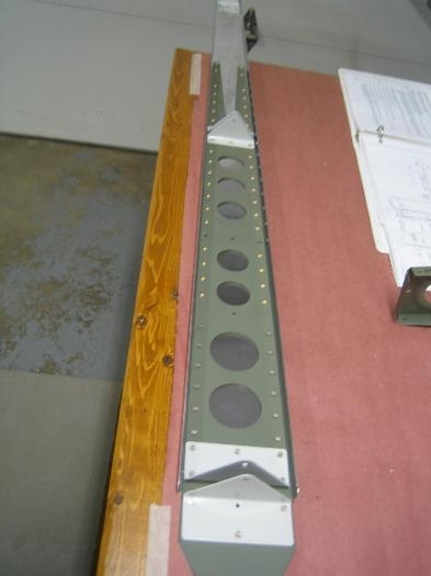

Clecoed the vertical stabilizer reinforcement plate to the spar channel (VS-803PP to VS-808PP).

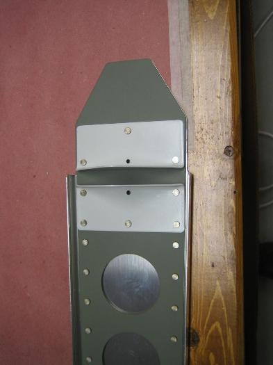

Clecoed the hinge brackets (VS-410PP, VS-411PP and VS-412PP) to the spar assembly. Taped over holes that will attach the VS-704, VS-706 and VS-707 ribs.

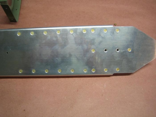

Riveted the vertical stabilizer rear spar together remembering the flush rivets on the lower end of the spar channel.
Vertical Stab Rear Spar
Flush Rivets Per Drawing
Bottom of Spar
Bottom of Spar
