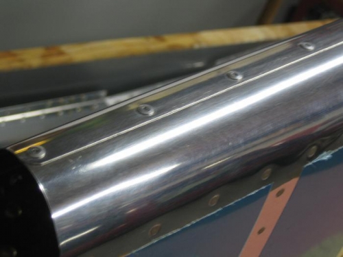

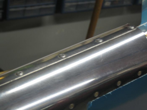

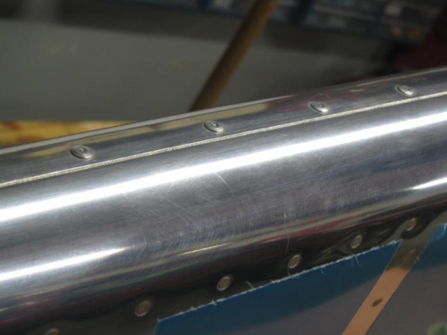

Reworked leading edge middle
Decided to remove rivets on middle segment of the rudder and re-roll rather than adding the extra rivets. This solved the problem and the reworked edge looks good, no gaps between rivets.
Leading Edge Middle (Left)
Leading Edge Middle
Leading Edge Middle (Right)
