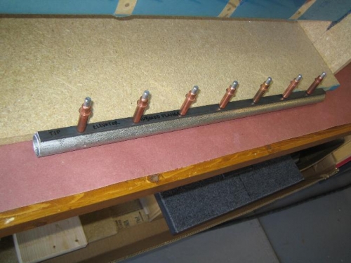

Brief Description:  First attempt rolling leading edge of elevator
Rolled portion of the leading edge on the right elevator per directions in plans (duct tape and 1" pipe). Was unable to achieve an acceptable lap joint. Will try an alternate approach.

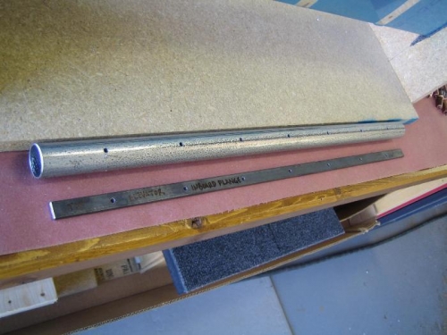

Pictures attached show the basic rolliing tool fabricated for one segment of the elevator leading edge. Following log entry shows tool attached to elevator skin.
1" Conduit & Steel Bar
Conduit & Bar Match Drilled
