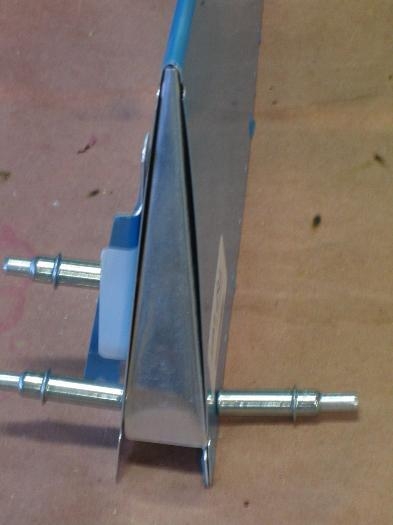

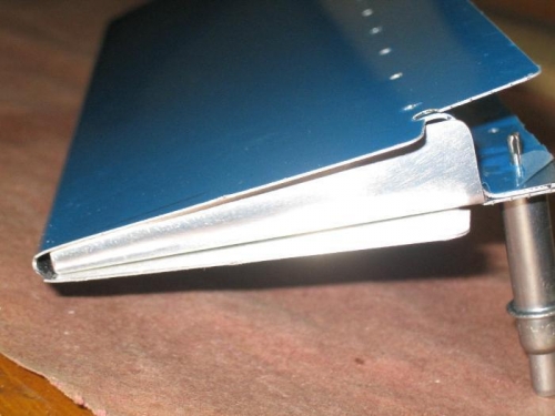

Completed the trailing edge bend of the E-619-1-020 trim tab skin.
Marked the excess portion of the trim tab for removal (this is the portion that is normally bent over to form the ends of the trim tab). Cut excess material with aviation snips and smoothed edges on scotchbrite wheel.
Fabricated two end ribs for the trim tab. Marked and match drilled the trim tab skin to the end ribs.
Trim Tab Outboard Rib
Trim Tab Inboard Rib
