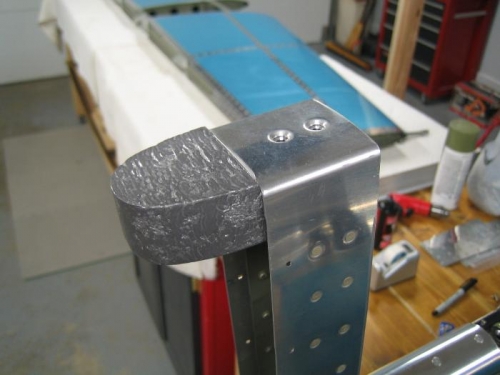

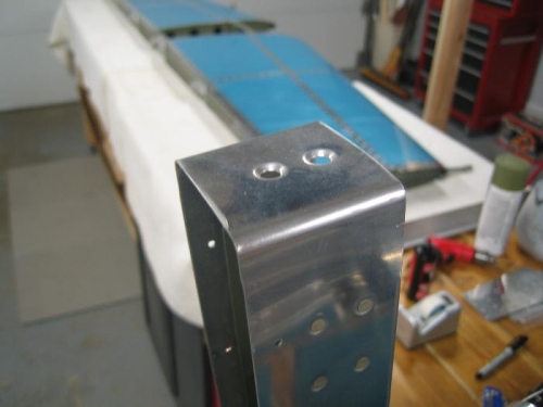

Dimpled the counterbalance skin for the screw heads that will attach the lead weight. Machine countersunk the lead weight for the dimples in E-713.
Machine countersunk the top flange of the trim spar (E-606PP) to accept the dimples in the E-701-L elevator skin. Dimpled the bottom flange of the trim spar.

Beveled the inboard and aft edges of the counterbalance skin (E-713) where it overlaps the spar and rib flanges. This provides a smooth transition between the counterbalance and elevator skins.
Dimpled Skin
Dimpled Skin
Counterweight Installed
