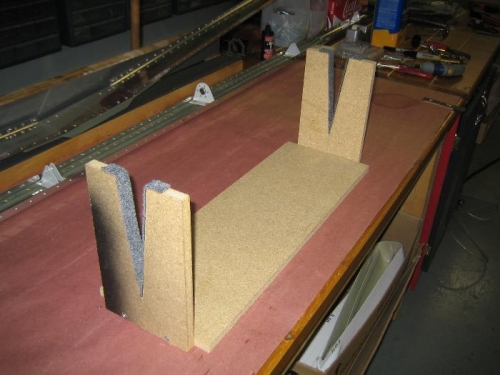

Brief Description:  Built bench fixtures to hold control surfaces
Built bench top fixtures to hold elevators and rudder for final assembly and riveting. Also built fixtures to bend tabs on left elevator and trim tab (tab bending device later discarded in lieu of fabricated end ribs for this appllication). Fixtures built of particle board with load bearing surfaces covered with carpet.
Elevator & Rudder Fixtures
