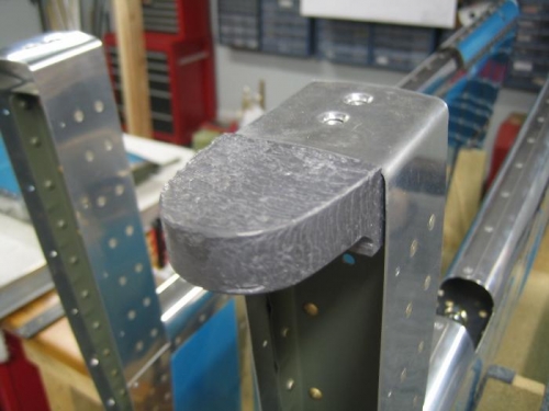

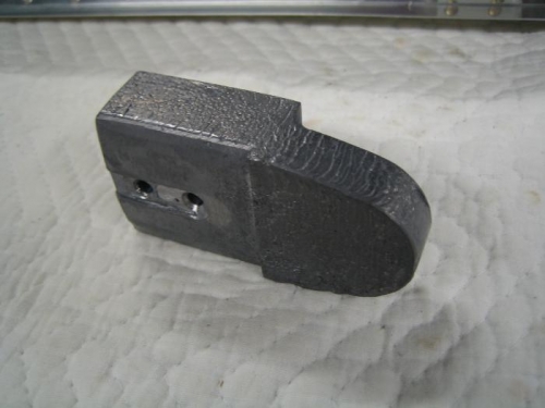

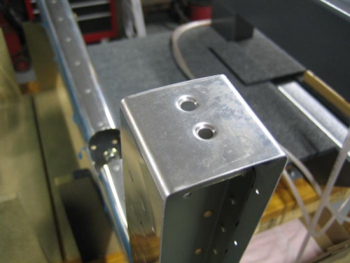

Dimpled the counterbalance skin for the screw heads that will attach the lead weight. Machine countersunk the lead weight for the dimples in E-713.

Dimpled
Dimpled
Shaped, Drilled & Countersunk
Installed
Installed
