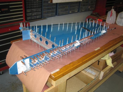

Match drilled vert stab skin to skeleton
Clecoed the vertical stabilizer skin (VS-801PP) to the stab skeleton.
Match drilled to final size all holes attaching the skin to the skeleton.
Marked the locations and orientation of VS-803PP, VS-411PP and VS-412PP.
Vertical Stab Assembly
Match Drilled
