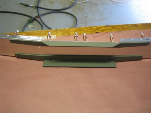

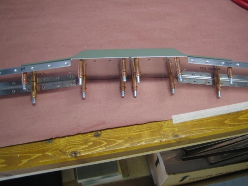

Brief Description:  Begin horiz stab front spar assembly
Clecoed the horiz stab front spar angles (HS-810-1 and HS-814-1) to the front spar channels (HS-702s).
Match drilled all holes inboard of the HS-404/HS-405 rib attach points (see view A-A) No holes drilled for attaching the HS-404 and HS-405 ribs or outboard of the bend liines (to be final drilled after bends are made).
Front Spar Splice Angles
